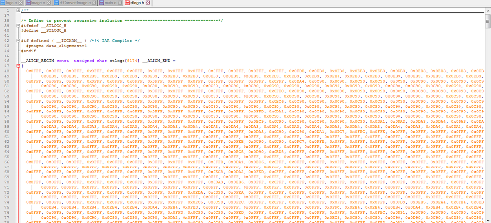

Thank you for the answer, but after generating code in .c with BitmpCV.exe I just copy the table in my .h file
stlogo.h
#ifndef __STLOGO_H
#define __STLOGO_H
#if defined ( __ICCARM__ )
#pragma data_alignment=4
#endif
_ALIG_BEGIN Const unsigned char stlogo [2795] _ALIGN_END {
copy of the table by generating BitmpCV.exe
#endif /* __STLOGO_H */

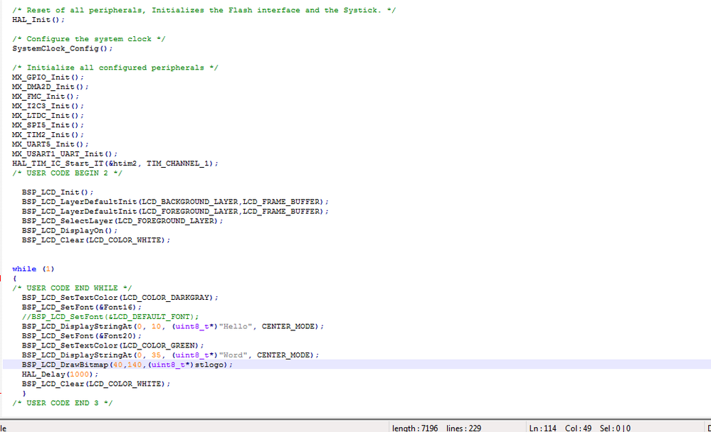

After my main.c
#include ''stlogo.h''
int main (void){
while (1){
BSP_LCD_DrawBitmap (40, (uint8_t *) stlogo);

2016-09-16 5:18 AM
Hello
, here are the
stepsfor
how I
try to do the same asthe example of
STM
1st step: I generate my
in table .cwith
BmpCVt.exe so I'll have my table soon after they are on 8bit 0xFFand
soon
both16bit
0xFFFF. 2nd step:I open
my
file
stlogo.h
I brought
to STMsample file
in STM32F4xx_DFP/2.9.0/Projects
/STM32F429I
-Discovery
/Examples /BSP/IncWith
their
table
it works fine I displays the ST logo. but if I want to put my table and I create with BmpCVt.exe clears their table and I put my table. it gives me nothing and the display will give me any results.

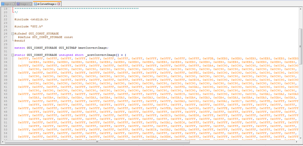

2016-09-16 8:30 AM
enedis.ibrahim
This is experiment with BMP internal data format.If the experiment
will succeed
, I made a template for LIC. Corrected code, format R5G6B5, in attachments.Try it and
let me know
the results.
________________ Attachments : image.h : https://st--c.eu10.content.force.com/sfc/dist/version/download/?oid=00Db0000000YtG6&ids=0680X000006HzmQ&d=%2Fa%2F0X0000000bPW%2F0phSQrsQdkka9wJWKHVVotH.lXB7yXHvPJf6GN0VurU&asPdf=false2016-09-16 8:50 AM
it was successful but it gave me an inverted logo with color green and orange
2016-09-16 9:01 AM
And try this attachment with inverted R/B colors.
________________ Attachments : image.h : https://st--c.eu10.content.force.com/sfc/dist/version/download/?oid=00Db0000000YtG6&ids=0680X000006Hzhg&d=%2Fa%2F0X0000000bPX%2Fq4JvYLn_aKuOky8355fmncF9B9R2zpg.cWEsr3iogq4&asPdf=false2016-09-16 9:08 AM

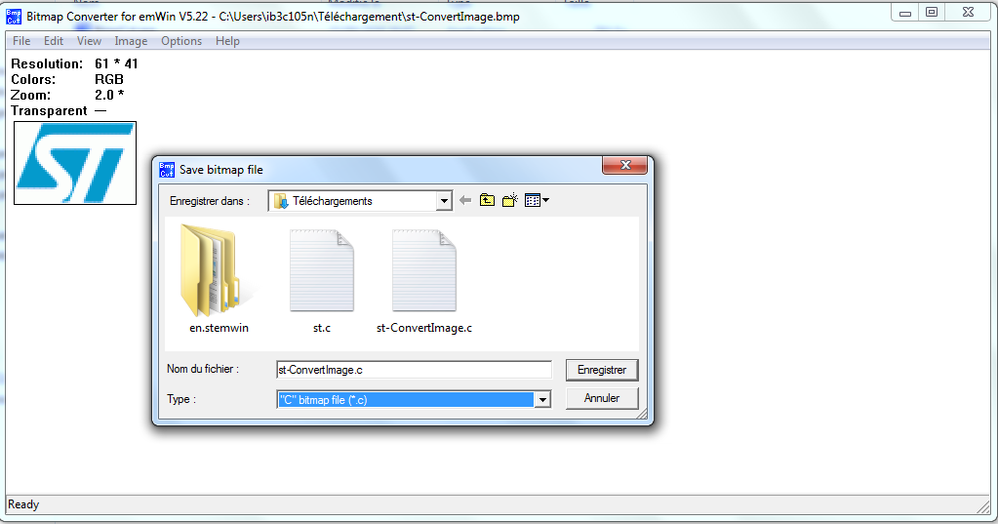

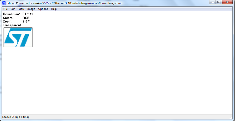

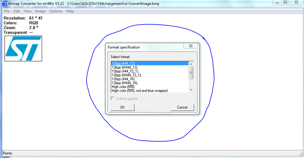

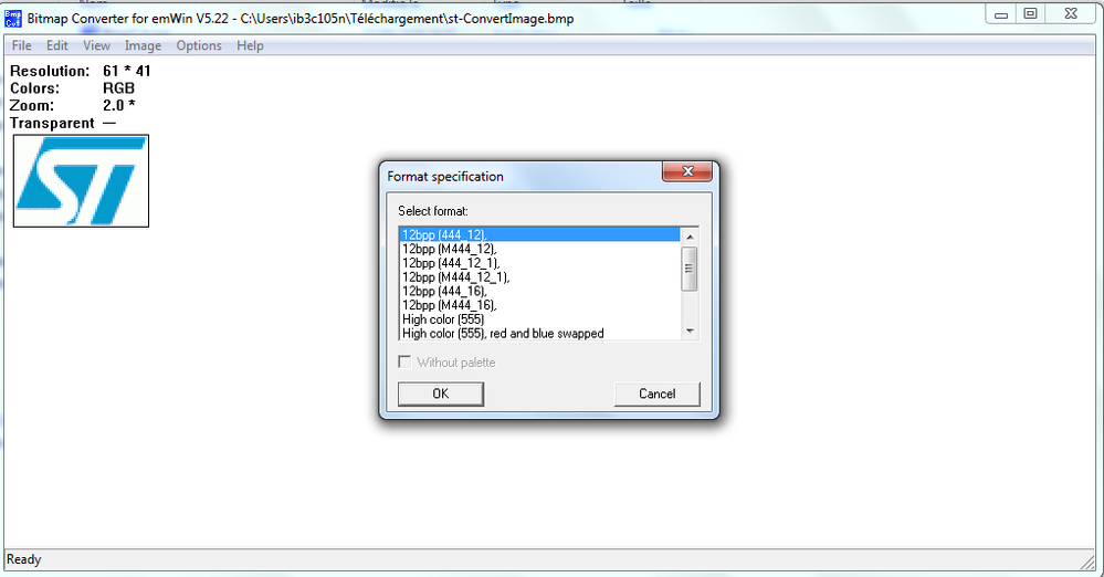

2016-09-16 9:47 AM
See attachments here.
