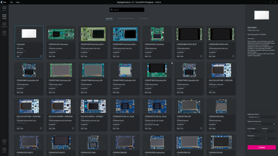

5) where can I find a list of displays that are already setup in TouchGFX?
You can find all the board + display combo already setup (by us or by our partners) by simply clicking "New", then "Create" and then you will see all the board + display combo already setup and you can search a specific board :
If this comment answer your question, I invite you to select it as "best answer".
