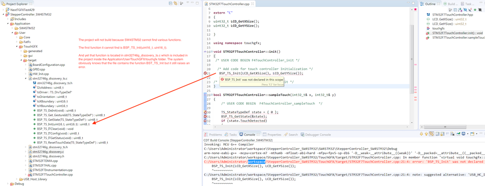

@Mon2
Well, I followed your tutorial as closely as I could while ignoring the differences between our target platforms, and I still get the same errors. Unfortunately, even though you place the BSP files in different places than I did, it still does not build. In my opinion, you place the files in a more logical place (inside the target folder). I placed them inside the Project/Drivers folder.
Here is a screen shot that shows very what is going wrong.
The screen shot is pretty big. I will also attach it as a file.
I'm about ready to throw a brick into my computer screen and swear off computers and programming and specifically embedded programming, SW4STM32 and ST. HA! Not really. I consider this a challenge. Eventually I know it will work. I just don't know when.
Unless you can see something idiotic that I am doing, I will post this image into a thread I have already created on the OpenSTM32.com forum. They've all ignored my previous thread, but this image seems so easy to grasp, maybe someone will help now.

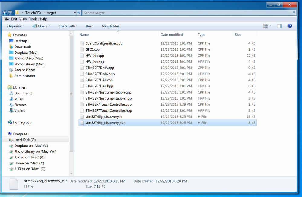

2018-12-22 8:57 PM
@Clark Sann , please confirm that you have ALSO copied the following 2 files:
stm32746g_discovery_ts.h
stm32746g_discovery.h
into your project's folder named target
This step is required even though you have already dragged & dropped the same files manually as can be seen by your file structure. Only then will the raised error be resolved.
Have not tested with the STM32746g_discovery kit but gathering in theory it should work.
Please confirm and update.

Those two .h files were copied into the TouchGFX/target folder in Eclipse and using Windows Explorer. Here is the view from Windows Explorer.

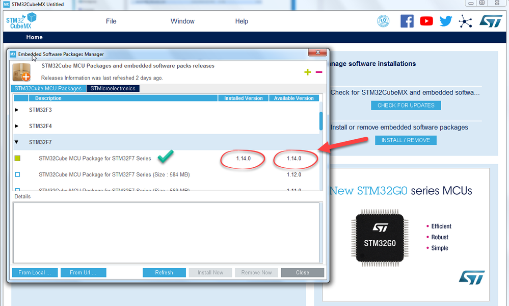

Wish to note that in all of the posted project solutions that worked for us, no path change was made inside any of the source code. Instead, the best resolution was to change the destination folders till the source code would compile as-is.
If practical, consider to install Teamviewer (free version is fine) and send the details for a quick remote review.
Be sure to have the latest STM32CubeF7 extracted to a local folder and also that the STCubeMX has the same latest release installed.
