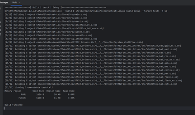

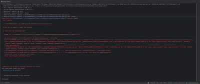

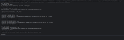

Here are some screenshots of what happened. I used the same version of CLion and CubeCLT in the same configuration on two projects generated by CubeMX6.15 and 6.14. One compiled and the other didn't. The project created with CubeMX 6.15 cannot build at all and prompts that the compiler is broken.
PS: I've switched back to 6.14.1 for some days and everything is working alright.

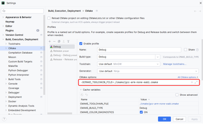

The root cause of the issue is related to how the toolchain file was specified in previous MX versions.
Previously, the toolchain file was defined in two locations: CMakePresets.cmake and CMakeLists.txt.
Starting with version 6.15, the specification in CMakeLists.txt has been removed, and it is now retained only in CMakePresets.cmake. This change was made to eliminate redundancy and to simplify switching between GCC and starm-clang .

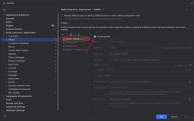

To be able to build the 6.15 projects with Clion we need to specify the toolchain file in the Clion project:
- Go to menu File -> Settings -> Build, Execution, Deployment -> CMake
- In “CMake options” field , we need to add the toolchain file variable for GCC :
-DCMAKE_TOOLCHAIN_FILE=./cmake/gcc-arm-none-eabi.cmake
Note: To use starm-clng instead of gcc, you need to add : -DCMAKE_TOOLCHAIN_FILE=./cmake/starm-clang.cmake
Thanks.
