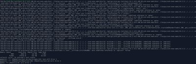

Then I'm adding C++ iostream usage:
A rebuild now fails reporting undefined reference for putwc/getwc.
Then I change the linker script to end with the following extract (:* removed) and it solves the compilation failure:
/DISCARD/ :
libc.a ( * )
libm.a ( * )
libgcc.a ( * )
