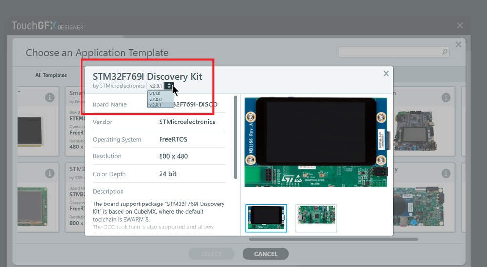

If you select V2.0.0 of the STM32F769-DISCO application template from the designer you should be able to program your board.
That article you're linking to exists to compensate for errors in CubeMX generation. I will remove it soon because as CubeMX improves TouchGFX code and project generation these articles lose their purpose.
The work has already been done for you in the F769-DISCO application template.
Check it out and let me know!

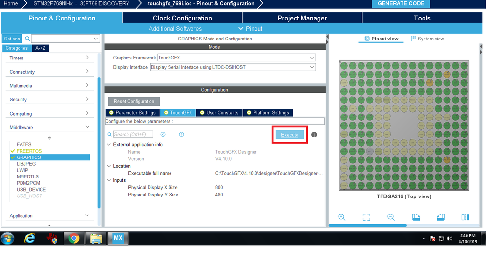

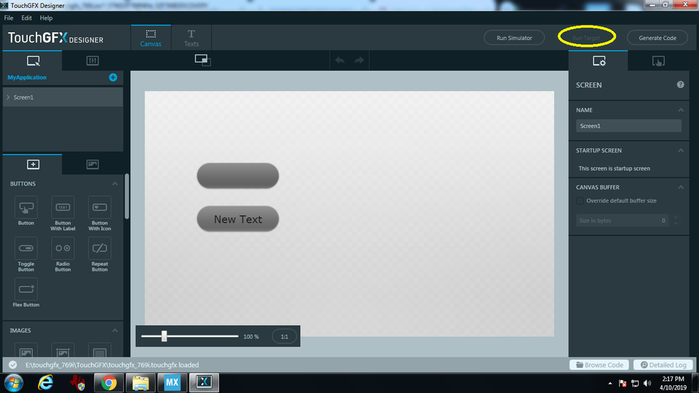

I am configuring the STM32F769I discovery Board in CubeMX and then use 'Execute' to generate the TouchGFXdesigner application.
But I think , TouchGFX doesn't maps the target correctly from CubeMX as the 'Run Target' option is inactive. (highlighted in yellow) Though it generates code without an error.
How can I select V2.0.0 of the STMF769-DISCO in the TouchGFX designer now?

This option to select the application template is available when I start creating my project in TouchGFX. But when I start in CubeMX and 'Execute' it from CubeMX, The TouchGFX designer automatically opens up but there is no option available to choose the application template from this route.
Also, if I wish to use Keil UVision (most of my team members are currently using Keil), is there an option to generate the Keil Project in TouchGFX for STM32F769I-DISCO?
