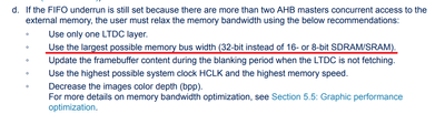

2025-10-23 5:15 AM
@mƎALLEm Thank you for sharing this image. Could you please let us know from which document this reference is taken? It would be very helpful for us to go through the complete section for better understanding.

2025-10-23 6:15 AM - edited 2025-10-23 6:16 AM
Sorry, I thought I provided the reference of the doc:
It's the AN4861 "Introduction to LCD-TFT display controller (LTDC) on STM32 MCUs" /page 27
