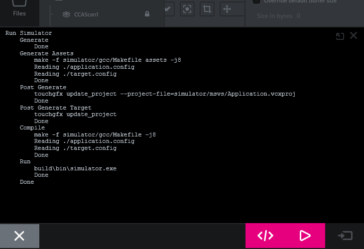

2023-01-25 6:35 AM
every time I press 'Run Simulator', the build system checks all targets if update is needed. This takes often up to 10s.
Is there any way to run immediately simulator.exe ?
Thanks
