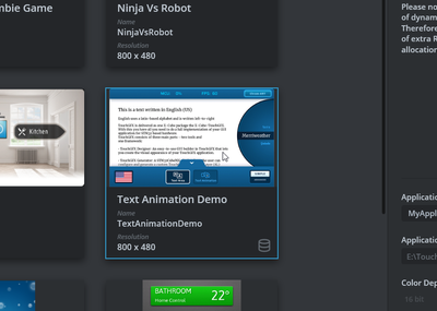

I would suggest you to look at the "Text animation demo) :
In it, you can look at the function "moveIsDone()" where we use the function "Texts::setLanguage(languageToBeChangedTo)" to set the new language.
