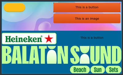

I'm trying to design a TouchGFX GUI using a background image that has some placeholder 'boxes' (that will eventually hold status of things) and custom flex buttons. I'd like these buttons to have rounded edges, so I am using PNGs with transparency around the edges. However, TouchGFX seems to ignore the alpha of 0 and fill that space with blue - see screenshots of the buttons below:
They appear the same way in the simulator. Am I doing something wrong?

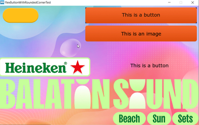

When a flexbutton is created, by default it will have a blue box as background, you then added your image with transparency (and sometimes a text) but did not remove the blue box :
Simply deleting the "Box with border" element fix the issue (here I only did it to the Heineken image):

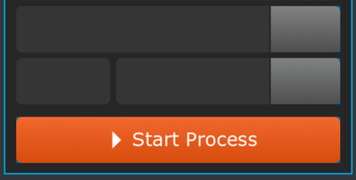

Thanks for looking into this, Gaetan!
Here are the buttons I was trying to place in the example above:
My button behaves the same way in your project. I noticed that your images are generated, where as I'm importing the graphic.
I've tried importing other transparent graphics I've found online. They all behave the same way - if I add them to TouchGFX as an image, they are transparent as you'd expect. If I add them as an image to a button, they are blue below the transparency - I included this random image to really emphasize the effect:
I have included the modified project so you can take a look.
Thanks,

2025-02-28 3:54 AM
Thanks, yu're right - this worked!
I actually tried to remove that border as soon as I added the flex button, but it wouldn't let me so I dropped it's size to 0 and hoped that was the equivalent. I see now that after you add another item (image/text/icon), you can delete the border - but that seems like a poor user experience.
