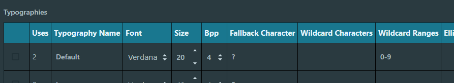

...To achieve this, your typography must know about a range of possible outcome values - So in this case where we'll be incrementing a value from 0 a range of 0-9 is the right setting.
