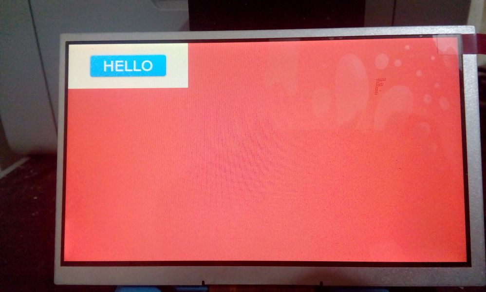

created a project to show just a button in 7" LCD 800X480 resoulotion

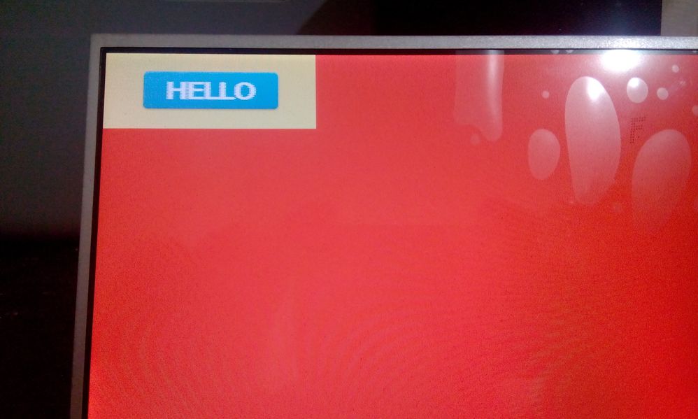

at first i programed the micro to use extrenal SDRAM as buffer but the picture went very bad
then i changed the SDRAM address from 0XC0000000 to internal address of 0X20020000 and i get this result which is perfect

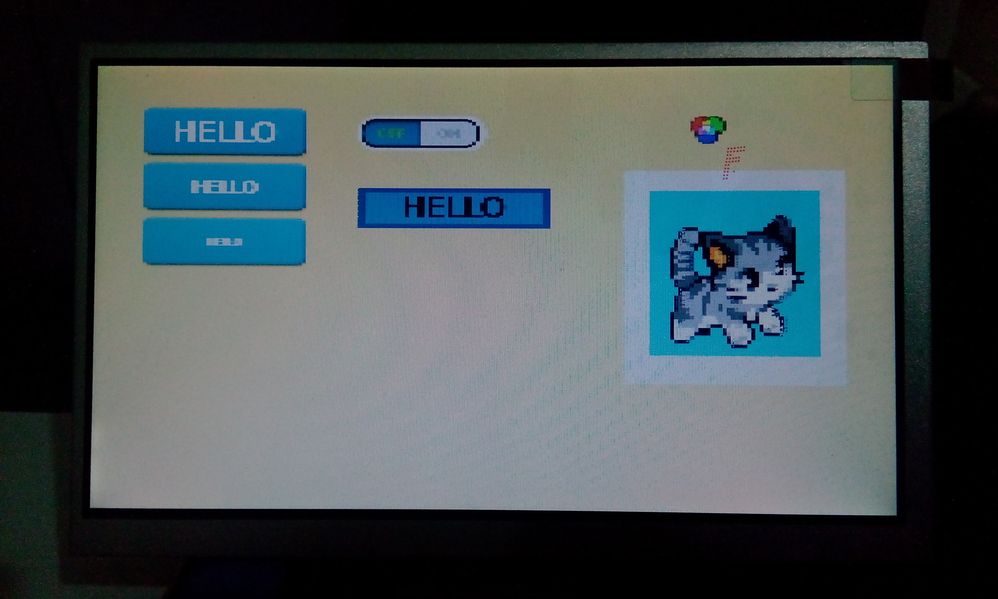

here is 2 other pictures from 800x480 test in external memory
and my memory configuration

yup that was a huge disaster , MODE setting should have been 0x130 , AutoFressh instead of SelfRefresh , and i am now getting the result i wanted took me 5 hours , thanks
