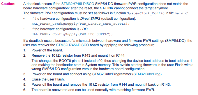

Hi @Community member ,
It is possible that a deadlock occurred on your STM32H745I-DISCO. To unlock it, please follow the procedure described in UM2488:
