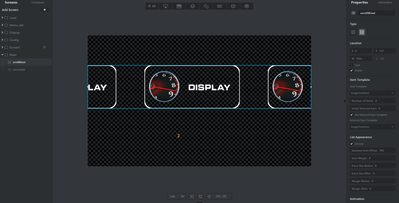

I want to make a scrollwheel as a menu, when the user clicks on the central image, the window changes.
By following tutorial 4, I managed to adapt it to my needs.
How to do so that when the user clicks on the central image, the window changes. I was thinking of reusing itemIndex via setNumber already used in MenuElement.hpp, but I can't do it.

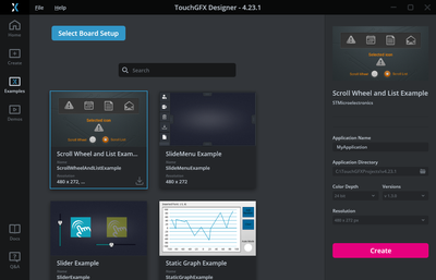

This example is made and tested in 'Scroll Wheel and List' example. It is also attached. you can run simulator.exe from \TouchGFX\build\bin to see what it does. Its made with 4.21.4 but most likely it can be opened also in the later versions.
This example project is bit confusing since there is also possible to select scrollList instead of scrollWheel, but hopefully it helps.

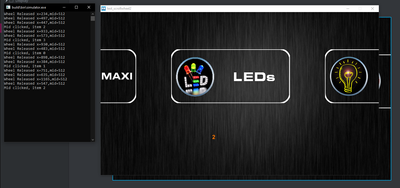

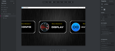

2024-02-18 2:10 AM
Thanks for the answer, my scrollwhell works and the icons change, but how do I click to make a choice. I find it surprising that I haven't found any tutorial on clicking a scrollwheel to choose an option based on drag?
2024-02-18 5:39 AM
or how to use "handleClickEvent" with a scrollwheel in tutorial 4

2024-02-20 12:18 PM - edited 2024-02-20 12:21 PM
Many thanks JTP
Thank you for your code, I was able to modify it and make it work on a single project but when I integrate it into a more complete project it no longer works. Yet I used the same screen...

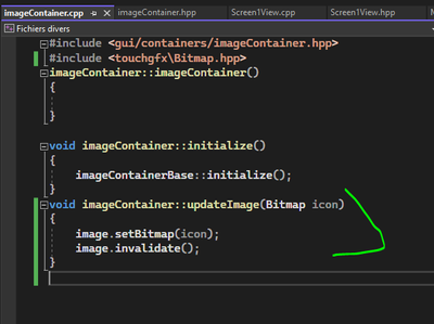

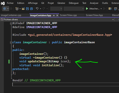

I have an error:
" gui/src/main_screen/MainView.cpp: In member function 'virtual void MainView::scrollWheelUpdateItem(imageContainer&, int16_t)':
gui/src/main_screen/MainView.cpp:74:14: error: 'class imageContainer' has no member named 'updateImage'
item.updateImage(Bitmap(BITMAP_ICON00_ID));
gui/src/main_screen/MainView.cpp:77:14: error: 'class imageContainer' has no member named 'updateImage'
item.updateImage(Bitmap(BITMAP_ICON01_ID));
code :
void MainView::scrollWheelUpdateItem(imageContainer& item, int16_t itemIndex)
//item.updateText(itemIndex);
switch (itemIndex)
case 0:
break;
case 1:
break;
case 2:
item.updateImage(Bitmap(BITMAP_ICON02_ID));
break;
case 3:
item.updateImage(Bitmap(BITMAP_ICON03_ID));
break;
2024-02-20 12:34 PM - edited 2024-02-20 12:35 PM
It's Works:grinning_face:
my error
Many thanks
