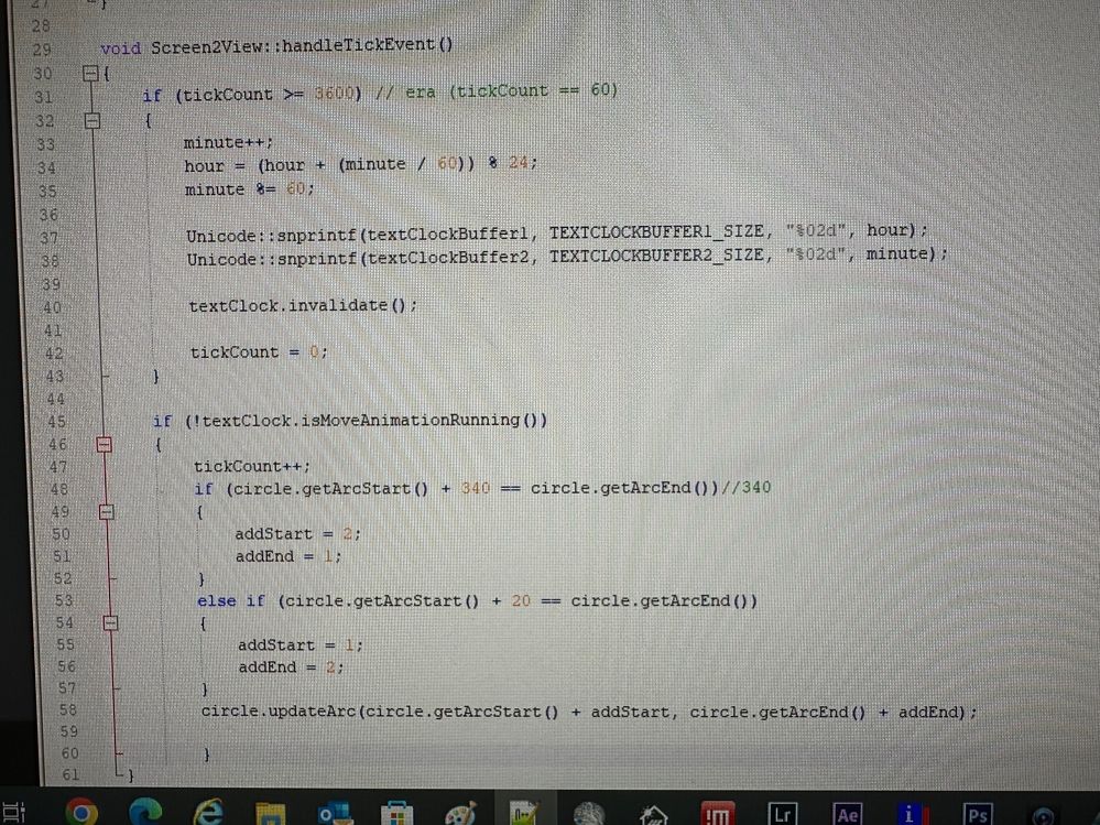

2024-02-19 8:43 AM
Hi, Little by little I'm learning something ;) Surely the error is there...... I changed the value from 60 to 3600 because the clock displays seconds and minutes by setting 3600 I display minutes and hours. Do I need to add a variable that only does the counting for the circle? Thank you.

2024-02-19 9:04 AM
I think no, the circles are updated at every tick.
