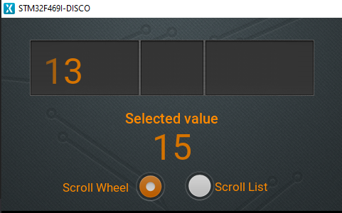

Hi again, I have just tested the example provided in UI template provided for ST (using 4.14 version), when you click the radio button Scroll Whell, there you can see the problem, there is a difference between the selected value and the value show into the scroll whell.
2020-10-12 5:19 PM

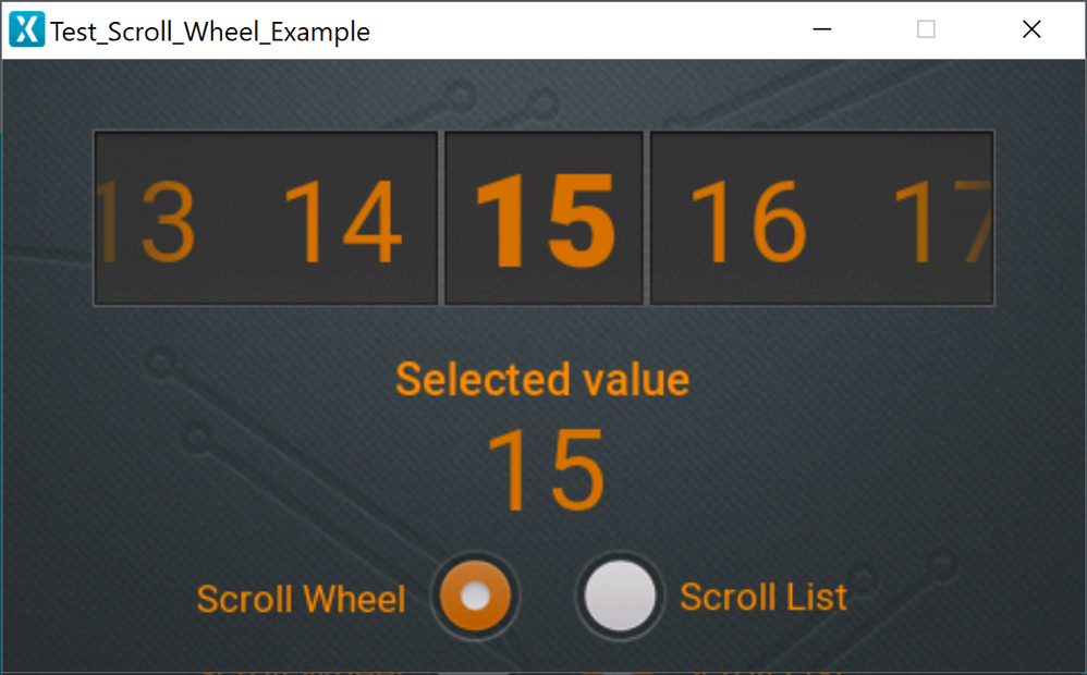

Your simulator is not showing something correct indeed. What did you do exactly ?
Because I did the same thing (with any version actually, you should never have this) and we tested it dozens of times. This is what I get :

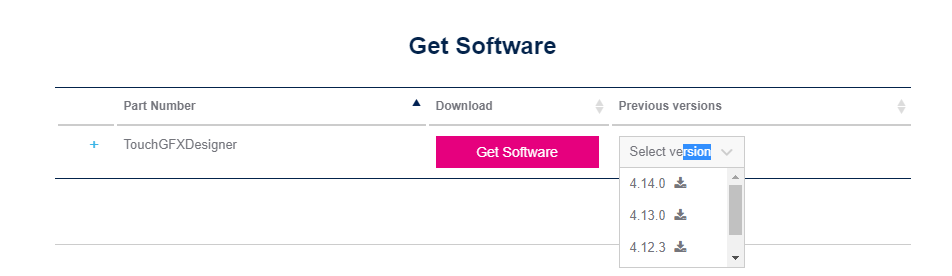

About to get 4.15 version of TouchGFX, is not possible only is eligible up to 4.14

2020-10-13 2:18 AM
I told you to click the "Get Software" button and what you are doing is click "Select version" menu. Just click the pink button.
Also if you look just above the Select version menu, it is written "Previous versions" which means it's PREVIOUS versions therefore not the current one ;)
