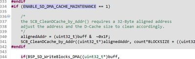

2026-01-06 10:44 AM - edited 2026-01-06 10:44 AM
Can you include your IOC file? I don't see the issues you mention in code generated for the STM32H743. The GitHub mentions some of these issues and says they have been fixed years ago. It's possible you're generating code with an old version.
"0x3" doesn't appear anywhere in the generated sd_diskio.c and it seems like the generated code is correct here (0x1F instead of 0x3):
The file only has 520 lines so I'm unable to compare lines 556-561.
