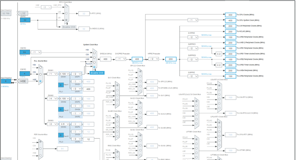

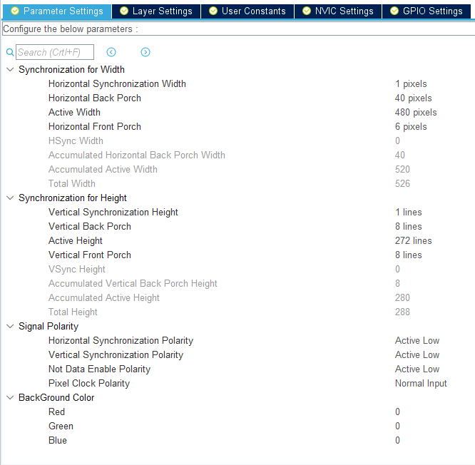

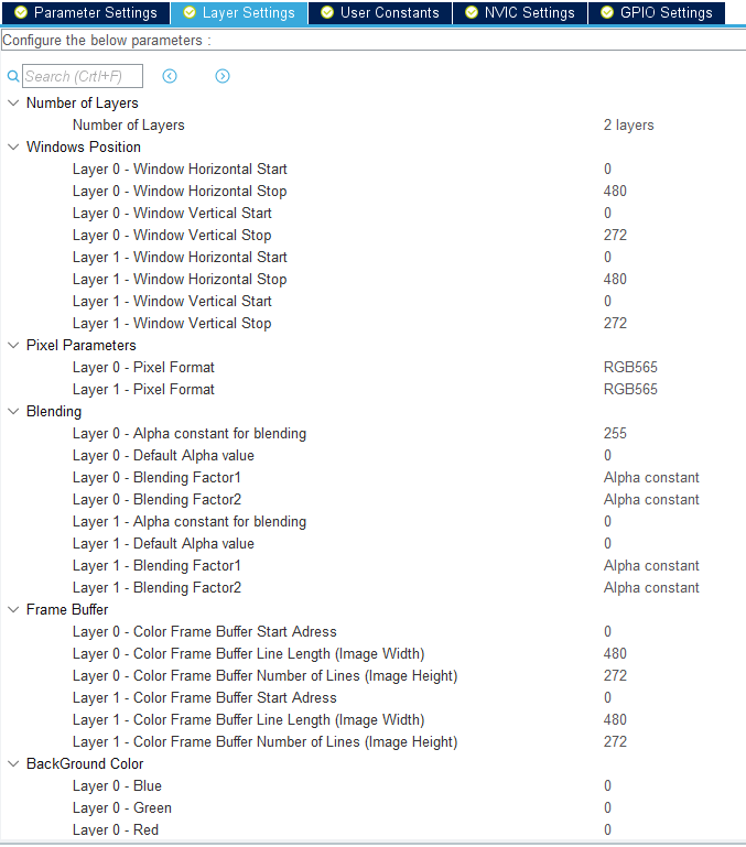

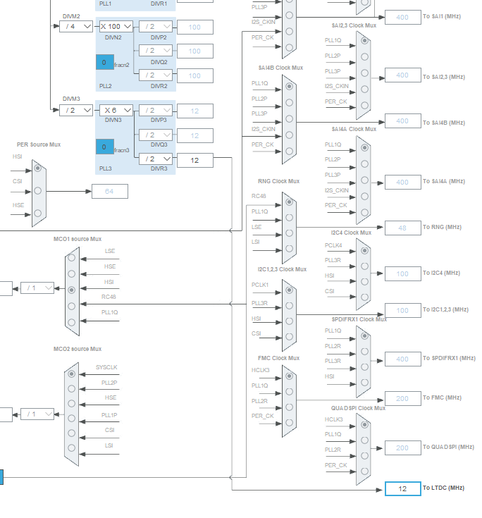

And this are is LTDC configuration and Clock configuration:
2020-10-13 9:45 AM
?? Frame buffer start address 0 ?? and why two layers
for your size and dot clock frame rate is 90Hz , isnt to big? Try change 12Mhz to 8MHz...
