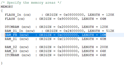

2. "SDRAM over 2MB fail" — we allocated 16MB:
Reply:
As shown in below attachments, our .ld file allocates 16MB for RAM_FB starting from 0xC0000000.
We are using:uint32_t frameBuf[(800 * 480 * 3) / 4 * 2];
This allocates ~2.25MB for double buffer with RGB888 (or ~1.5MB for RGB565).

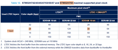

3. appnote define max clock for double buff with DMA2D to 36MHz on 24 bit. You use 33,33 , then your memory and MCU config cant differ from optimal max more as 8%:
Reply:
As per the "Table 12. STM32H742/43/45/47/53/55/57 and STM32H750 maximal supported pixel clock" in application note AN4861, page number 29 (see attachment shown below), max pixel clock for STM32H750 with:
LTDC + DMA2D
RGB888 (24-bit)
→ is 38 MHz.
We're currently using 33.33 MHz, which is close but below the threshold.
To be on the safer side:
Would reducing the pixel clock to 20 MHz be a good fallback?
Is there a recommended “safe margin” (%) for SDRAM when nearing LTDC+DMA2D bandwidth limit?

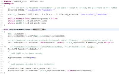

We have configured double buffering in TouchGFXGeneratedHAL::initialize() and assigned two buffers using setFrameBufferStartAddresses(...).
Please refer to below attachments for the exact configuration.
Do you see anything missing in our implementation?
Are there any additional steps in TouchGFX/target/ or HAL/CubeIDE beyond this setup?

As per your suggestion, I made the necessary framebuffer-related changes, detailed below:
Added memory section directive:
LOCATION_PRAGMA(".bss.TouchGFX_Framebuffer")
uint32_t frameBuf[(800 * 480 * 3 + 3) / 4 * 2] LOCATION_ATTRIBUTE(".bss.TouchGFX_Framebuffer");
setFrameBufferStartAddresses((void*)frameBuf, (void*)(frameBuf + sizeof(frameBuf)), (void*)0);
Updated include and display type to match 24bpp format:
Despite these updates, the flickering issue remains unresolved.

Your elementary basic mistakes continues
setFrameBufferStartAddresses((void*)frameBuf, (void*)(frameBuf + sizeof(frameBuf)), (void*)0);little explain you alocate x2 one buff , but here second buff place to address after first x2.... unalocated space
More clean is create fbuf1 and fbuf2 ...
Next in appnote is described , that better is place starts on sdram pages starts. For example if your sdram banks is 2MB size then fist buff is C0000000 and second C0200000, this memories is reserved in linker script and allocated by address, no as your by linker.
