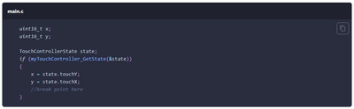

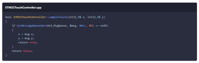

2025-07-25 10:55 AM
Bad advice in the ToughGFX docs then:
