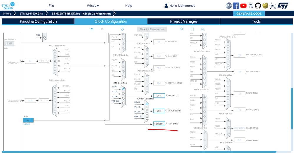

Primary contrl for framerate for RGB displays is LTDC pixel clock. Simply in clock config set PLL.
Too good is calculate actual frame rate FR= LTDCclk / (totalwidthxheight)

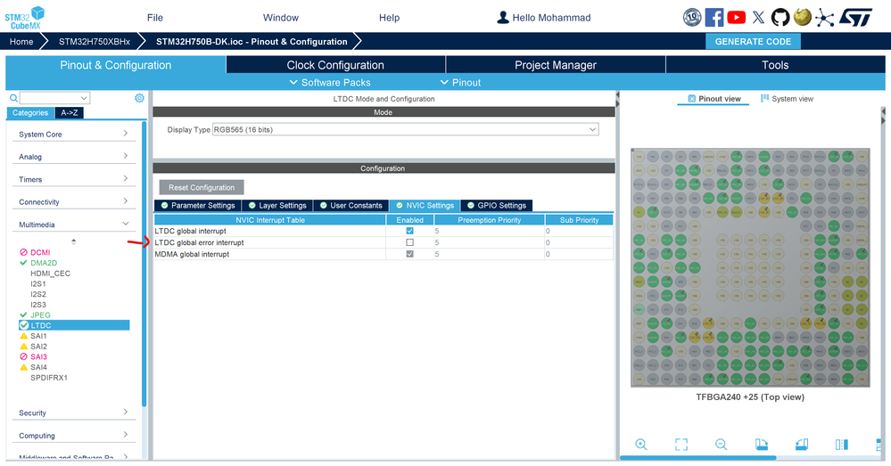

You can enable the LTDC global interrupt to catch the underrun interrupt; however, it is not very helpful for measuring the performance. You can enable it from the Multimedia tab, LTDC -> NVIC Settings inside you STM32CubeMX project.LTDC global error interruptLTDC global error interrupt
But, as our amazing friend @MM..1 mentioned, you can easily adjust the frequency of the LTDC signal by changing its clock speed from the Clock Configuration tab in the STM32CubeMX project.
Changing LTDC pixel clockChanging LTDC pixel clock

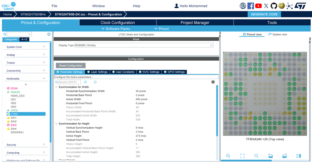

Additionally, if you wish to change the parameters of your LTDC (such as the porch dimensions), you can navigate to the same settings as for the interrupt. However, instead of selecting NVIC Settings, choose Parameter Settings.
LTDC parameter settingsLTDC parameter settings I hope this helps you.
