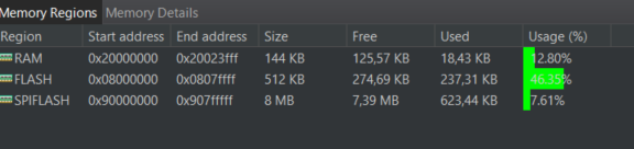

2024-02-28 6:16 AM
Thank you for your response. I am using NUCLEO STM32G0B1RE kit that have 64 MHz clock and 32 Mbits/s SPI. But the external flash IC is in custom board. DMA is activated. Memory of my flash IC has 8 MB. And indicator of capacity is ~8% for ext flash IC.

My memory state is the following SS.

Hello again,
Unfortunately, the MCU that you mentioned is not capable of handling Scalable Images. Instead, you can store multiple sizes of the image you like to scale as a simple solution and go through them. I know it is not the best solution, but it can help you.
Don't hesitate to ask more questions,
Good luck
