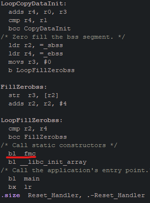

So Im trying to move heap to my external SDRAM and the problem is that it hardfaults after 3s and do not know why.
In startup file before__libc_init_array i call fmc function which init SDRAM.Fmc function looks like this:

I call fmc here:
Yes, as I said when I upload code it start up and if I do not go to another screen it works perfectly fine, but when Im trying to do that it hardfault after uploading next screen view. During loading screen it creating objects
