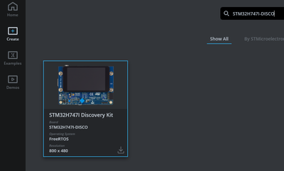

I'm using the STM32H747I-DISCO board for quick prototyping and to explore the STM32 family.
If I go with the "new clean project" approach, I wonder — can I leverage the fact that this board is officially supported?
A lot of scripts and boilerplate are already generated by ST’s tools. Couldn't I just copy/paste many of these into my custom project instead of redoing everything from scratch?
If I were to implement TouchGFX from scratch in a new project, how should I go about it?
I've found two long videos that explain how to set up TouchGFX on a custom board, but this isn’t a custom board. I could treat it like one, but I feel like I’d waste a lot of time when I could be using ST’s built-in support and integration instead.

As STM32H747I-DISCO is natively supported by TouchGFX, is convenient for you to start with TouchGFX then add Ethernet.
But you need first to check the RAM used for both functions in order to prevent any overlap. Check also the MPU configuration.
You need to go step by step by adding functions, so don't go add all the staff from the beginning.
