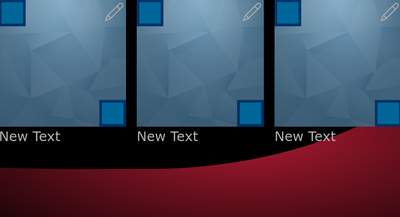

So I need to have a screen with a scroll list in which different elements will appear depending on the amount of elements stored in the local database.
I want each line to have 3 elements, so my question is, how is this ment to be in touchGFX? I have designed a custom container that has one element but I dont get how this expands downwards,
I mean, I have set the list to expand to the right, but i want it to grow another line when an elemnt doesnt fit in the same line. And i want it to be scrollable vertically not horizontally
I don't get how this is supposed to be done, the only thing i can think of is creating a clone of the same container under the current container but I think this is a bad solution.

Hello @I_ve_got_a_problem ,
So you want to be able to have multiple elements inside a container that will be 3 elements wide and infinite elements height. You want to be able to scroll up and down, not left and right.
In that case, a scrollable container would be the best option.
If you set your scrollable container's width to be 3 time your element's width then you can add 3 elements per line and then add 3 more on each new line.
To do so, insert a scrollable container to your design and disable "Enable horizontal scroll" on the right properties:
You can either add your elements manually by inserting one of your custom container and dragging and dropping it to your preferred location.
You can also do it dynamically if you have a lot of elements by using the method setXY such as :
myNewElement.setXY(theXposition, theYposition);
And then adding the element to the container such as :
scrollableContainer.add(myNewElement);
(Don't forget to invalidate ;))
For a 200 width by 300 height custom container it would like this :
myNewElement.setXY(200 * (elementNumber%3), 300 * (elementNumber/3));
Note that I use an index variable (elementNumber) to know where to place the following element.
I have made an example that adds the elements dynamically (up to 10) by clicking a button.
In my example, I have to take in consideration the amount of scroll that was already applied to the scrollable container so my setXY method looks like this :
myElement.setXY(200 * (elementNumber%3), 300 * (elementNumber/3) + scrollableContainer.getScrolledY());
