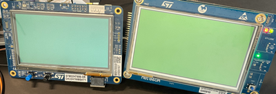

2025-07-30 2:06 AM
It is difficult to capture accurately in an image, but I have tried to compare the STM32H750B-DK with the STM32U5G9J-DK2 in the image below.
The color on the STM32U5G9J-DK2 doesn’t exactly match the color displayed on my computer monitor either (it appears slightly darker on my monitor). However, I cannot determine which one is more accurate.
Note: To my eye, the green on the STM32U5G9J-DK2 board appears a bit darker than it does in the image.
