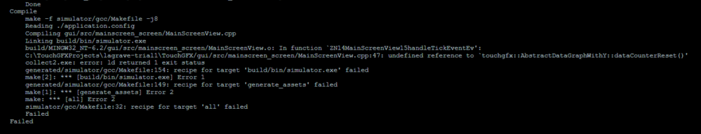

Thanks, but it gives this error
2021-04-06 7:55 AM
Did you add the dataCounterReset code in the AbstractDataGraph.cpp file?

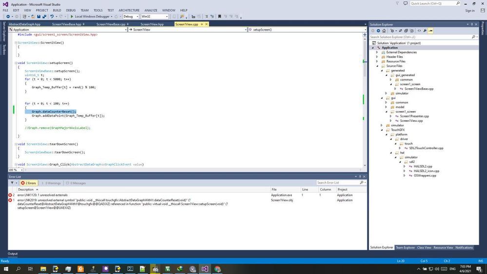

2021-04-06 7:35 PM
It seems I have the same error as @mbagh.1 , and I already ensure I add add the dataCounterReset code in the AbstractDataGraph.cpp file

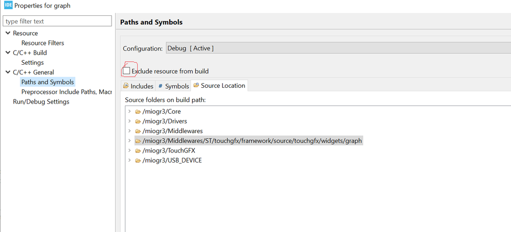

Anyway, how to do this:
"2. Then, in the properties of Middlewares / ST / touchgfx, unchecked the "Exclude resource from assembly" checkbox and compiled the project."
Any SW tool to uncheck this option?

Unfortunately, I used the stm32cubeide program. Perhaps AbstractDataGraph files are not included in the assembly.
2021-04-07 1:05 AM
It seems there was a mistake in my comment. If I remember correctly, it was necessary to uncheck this checkbox in the project properties(stm32cubeide).

I did not understand this part
2. Then, in the properties of Middlewares / ST / touchgfx, unchecked the "Exclude resource from assembly build" checkbox and compiled the project.
2021-04-09 7:30 PM
Hi @mbagh.1 , I think what @Vladimir meant was that he needed to exclude particular code folder which was touchgfx designer related to make the project in Cube IDE able to build.
However in my case, to resolve the issue in this forum, it is suffice as what @Michael K summarize
