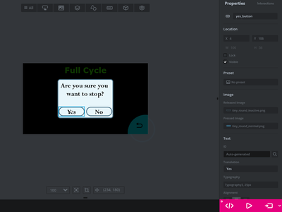

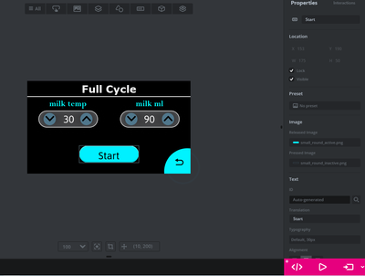

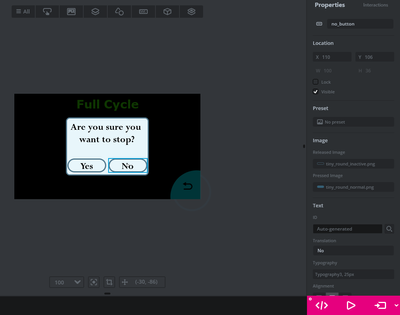

I Configured the Display, but TouchGFX isn't working correctly. The button touches aren't registering properly; they react continuously even before I release them.

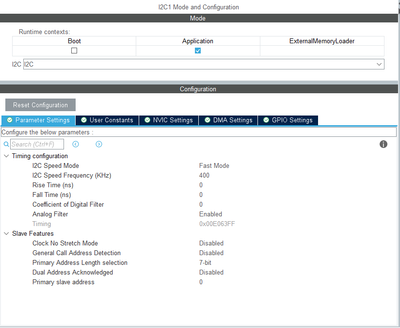

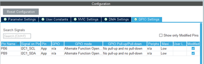

Hello @Sanjay27 ,
Could you check you I2C1 config? Because the sampleTouch function reads touch status from it (at least from our TBS)?You can read more about that in our documentation.

Hello @Osman SOYKURT
The Buttons are Reacts before release, see the Pictures and attached video files

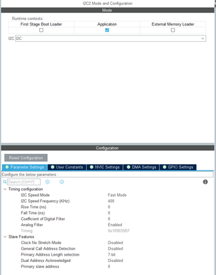

2025-12-18 1:34 AM

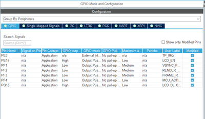

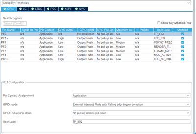

Ok, could you now check your TP_IRQ_Pin configuration on STM32CubeMX ?
You can also check you i2c configuration (I would suggest to make it similar to our current) :
2025-12-18 2:56 AM
My Configurations Still not working well
