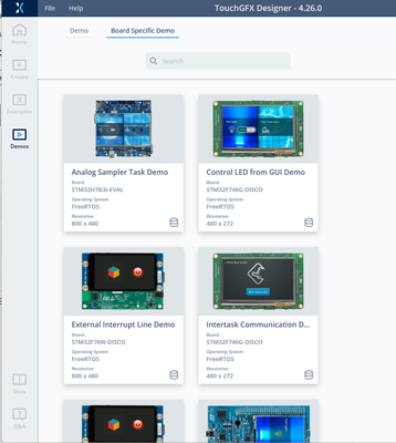

You can also find some examples of how to do things like that as board specific demos in TouchGFX Designer, although none of them are for your particular board:
