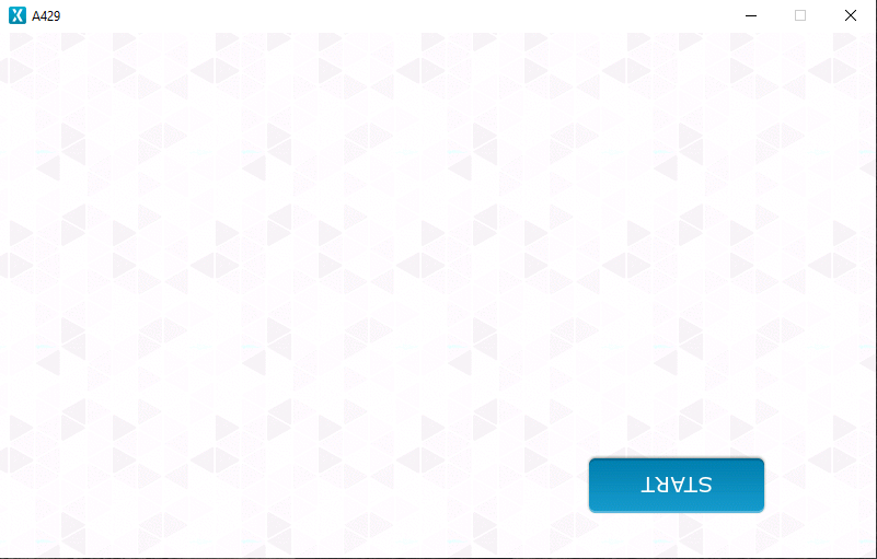

I have a TFT display with a resolution of 800x480 and STM32F429. Used the code from here https://community.st.com/s/question/0D50X0000A1lVxsSQE/repost-change-lcd-orientation-in-180-degree , everything works fine in the simulator

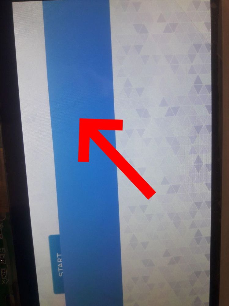

and separately tested on the 476H Discovery but on the TFT with F429 does not render different areas

}Everything works fine without a mirror and these empty zones appear in different places
