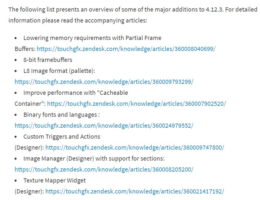

I'm pleased to finally be able to announce the release of TouchGFX 4.12.3, the first official release since 4.10.0. We've worked with CubeMX and CubeIDE to improve the integration experience some, so please get the latest versions of those (5.4.0 and 1.1.0 respectively). For CubeMX, you can upgrade to 5.4 through the software updater, or you can download it from st.com as usual.
Please read the following for an overview.
https://touchgfx.zendesk.com/hc/en-us/articles/360009767400

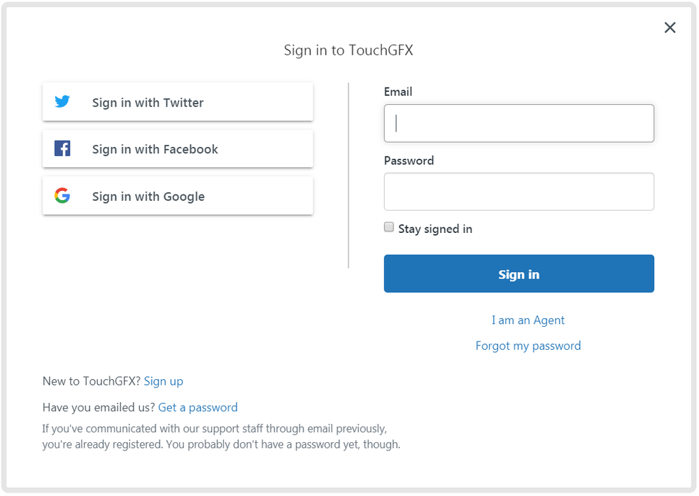

I tried clicking on all of the links to articles on the release announcement page (https://touchgfx.zendesk.com/hc/en-us/articles/360009767400:(
All of them took me to a sign in page:
