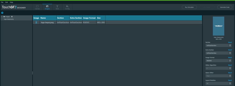

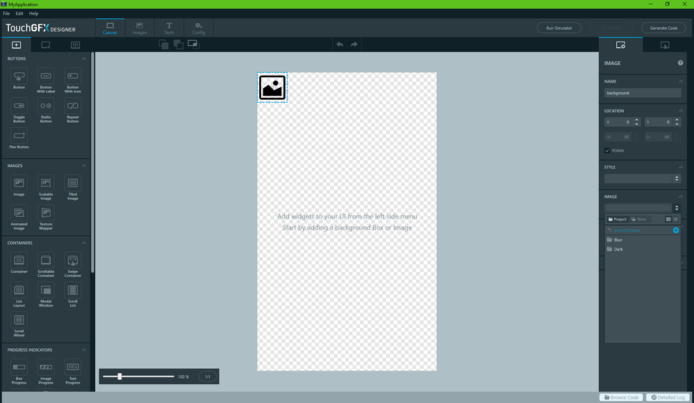

Hello agaian,
Some thing defenitly wrong with my TouchGFX.
Here is what i am doing:
But if i use 4.10.0 version, there is no such problems.
Is this only valid for me?
