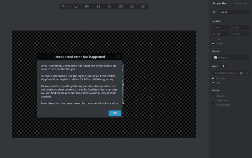

2025-02-07 6:09 AM
Hello @GaetanGodart,
when I try to insert a video into a screen I get this error window. What is it about?
2025-02-07 6:14 AM
Hello @TechnicalPBG2025 ,
Can you reproduce the bug, then right after, send me the logs and tell me the steps to reproduce the issue so we can investigate?
Regards,
