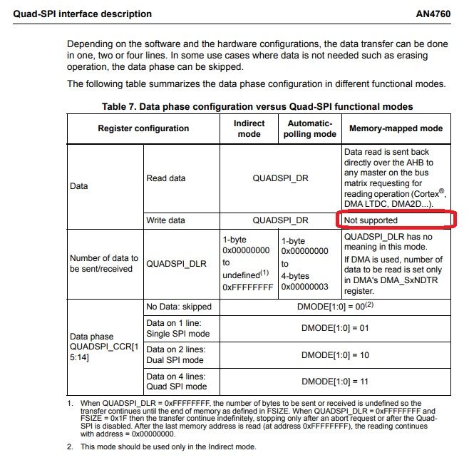

Ok, so where we get into the implementational weeds here is that you can't Write in Memory-Mapped mode, and you can't concurrently use Memory-Mapped with the other modes you can Read/Write with.
#PlanSurvivesFirstContact

I think the app note covers a lot of territory, not seeing that quote in V3
One of the F479 pages says "The Dual-mode Quad-SPI running at 90 MHz enables cost-effective NOR Flash and supports memory-mapped mode.", and I'm pretty sure it is an early instantiation of the QSPI peripheral, and only recall it having a singular template for the memory-mapping mode, which is what the LTDC is going to need to fetch against.
https://www.st.com/en/microcontrollers-microprocessors/stm32f469-479.html
2021-08-25 9:55 AM
You mean AN4860
2021-08-25 10:02 AM

"I don't think the F479 supports QSPI RAM"
Let me rephrase that..
It's not going to support it in a way that rational developers would need/want it too to achieve goals of acting as a random access memory, within the MCU address space, with read, write and DMA operation.
