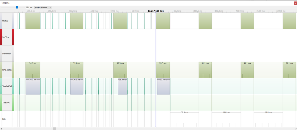

Hi ! I'm currently working on a STM32H747-DISCO with TouchGFX to test and discover this graphic library.
My touchGFX app is only 2 screens with a button to go screen 1 or 2 with a slide animation.
But when I'm implementing an other task in FreeRTOS with a higher priority, TouchGFX freeze at some point when i'm changing screen. My goal was to see when the animations of the library would lag with an other task running on the M7.
Do you have any idea why the screen freeze ? It may be linked to the slide animation of screen.

Some updates over my problem :
Here is the file SVDat if you want to look at it : https://drive.google.com/file/d/1Z3YvgpPZ90nGc7_hL4iW0EWeuJfaSyFT/view?usp=sharing
Thanks !

But...,osDelay() will call vTaskDelay() which will call vTaskSuspendAll(), this means you suspend the scheduler and leaves interrupts enabled, when TE (GPIO line)arrived, HAL_DSI_TearingEffectCallback()() is called in interrupt handler, DSI start to transfer the frame buffer data to screen with help from LDTC interface , and call OSWrappers::signalVSync() to signal TouchGFX egine to start render work again,this function put a message in queue and returned, this procedure avoid tear effect on srcreen.
so when CPU_BURNER_task1 run and suspend the scheduler somehow, TouchGFX engine lost chance to render. TE always come, and signalVSync() called again and again, the message queue just one place, you can't put them in?
You may instead osDealy() by for() to see what happed.

Okay, It seems I don't really understood what you meant by "You may instead osDealy() by for() to see what happed."
My goal is to suspend my CPU_BURNER task to let TouchGFX's task breath and see what happen if i stress it too much.
I can't suspend a task with a loop? I need to use vtaskDelay() anyway no ?
