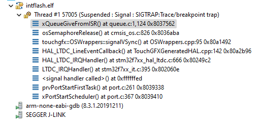

As far as I understood, you haven't experienced the freeze with the application with similar GUI but less calculation underneath. Could you explain a bit what those heavy calculations are? Are you getting data from USB or other peripherals or is it just data from inside the application (I mean from GUI)?
Plus, can you send a picture of the stack-call when the freeze happens?

Hello @Mohammad MORADI ESFAHANIASL Thank you for inquiring!
We have had a lot of issues with our device crashing gracefully to capture the stack call, but did manage to get something here...
along with a good register output...

What we were doing at the time of the freeze is a recursive quickSort of about a thousand double values, to give context of whats going on. Specifically we had set a breakpoint at the start of the quickSort, continued after it hit the start of it and then the device froze. Normally when this happens and we're connected to our debugger, the device's CPU will just stop everything and we wont be able to connect to the device via the debugger. For whatever reason, this current crash stopped the device but didnt stop the CPU, so we were able to pause the debugger and see it paused with the above stack call. Resuming the build just results in the same location when pausing again.

Hello @MitchellB ,
Sorry for the late response. I took a look at the information that you have provided, but unfortunately, I couldn't infer anything useful out of it. What I suggest is to be cautious about the priority of your tasks, and try not use Model.tick() directly. Instead, try to use HandleTickEvent functions in your View classes. However, the MCU crash that you mentioned sounds way more devastating than a simple GUI freeze because you get disconnected from the debugger and the MCU stops working. So, there is a chance that you are trying to get performance out of the STM32F7 boundaries.
