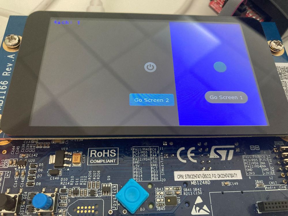

Here is the amin files of my small project.
I use Get Run Time Stats from FreeRTOS to monitor the CPU's load with 2 tasks :
There is also a folder for SEGGER RTT because i'm using RTT printf when debugging with a JLINK probe.
My TouchGFX application is composed of 2 screens, nothing crazy :
When I'm trying to get the application lagging it freeze the majority of the time and i get stuck with a screen like this one (here in during a slide) :
