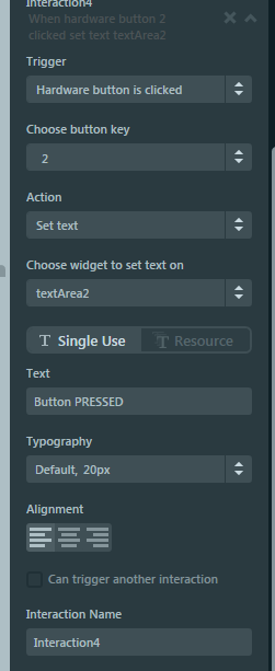

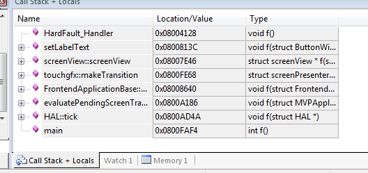

All working very well.
I checked many iteractions, triggered by button click.
But then I add iteraction which changes TextArea after buttonclick - program goes to HardFault immediatly after start.
What's wrong?
