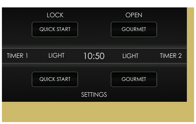

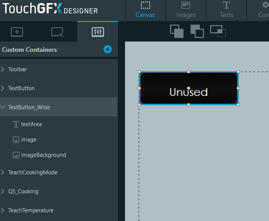

Here is the TouchGFX custom container, and the output from a screen with 4 of the custom containers.
Notice below how to the left and the right of the text on each button, how the background is the Screen's background, and
NOT the buttons background.

2020-05-14 12:29 PM
My image is only a border, the internal of the border, is transparent.
So the text should appear on the imageBackground, but appears on the screens background.
Don't use a standard button, which is filled in.
2020-05-14 12:32 PM
I think I understand my problem, my image was the wrong image, and is this.
Which will cause this behavior. I thought I was using another image, which is only a border, and transparent center.
