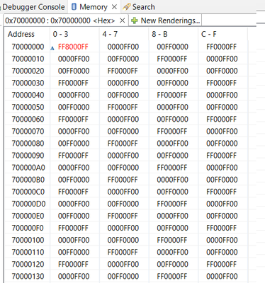

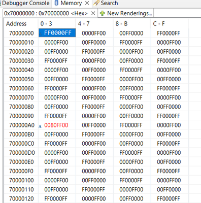

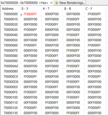

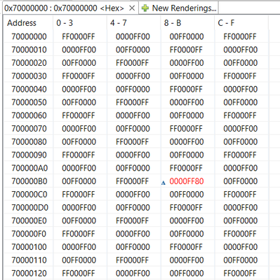

I have done more tests.
I have placed the screen all Blue. In debugging I have been looking at the external RAM, and I could see the following errors. And they repeat.
Any idea why that could be?
Try direct write to problem place.
*(0x70000000) = 0x....
and better big rectangle write from c code , not from touchgfx render.
I think its jitter, this is serial , this can be only this, because 8 value  is 1000b and this is the first bit after 0xF (1111b). Check the clock line and try different serial resistors value. In first, put 0R and try.
