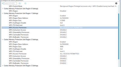

Hi fernando, you do not set MPU, the MPU is very important for RAM settings.
