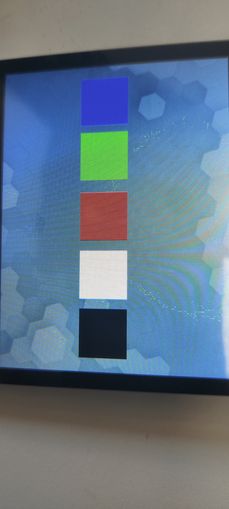

Hello.
I have made a custom project with STM32H735IGT. I use Touchgfx.
I am using external flash and external RAM. The problem is when I place the framebuffer in external RAM. Some green pixels appear as in image 1. When I place the framebuffer in internal RAM, the image is painted well.
I am using IS66WVH16M8DBLL-100B1LI RAM. I attached hardware configuration, the RAM is OCTOSPI2.
video of the problem and .ioc:
Where is the problem?

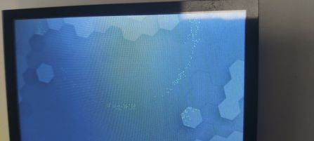

it seems that it is a signal synchronization problem. I have changed the resistances of the CLK and DQS. For resistances of 120. It seems that the problems have been solved. We have ordered the new 4-layer PCB. When I do tests on the new board, I will write to you.

hi, this is not a read/write problem in RAM, if you look at your problem you realize that the green pixels are positioned circularly on a shade of the image, therefore typical of a particular color. I believe that you have some problem on the LTDC transmission line of the display or from the RAM to the micro, and that it concerns the low bits of the line itself. Probably the RAM line since the problem is not found on the LTDC when internal..

At first I thought it was the LTDC, but in the internal memory it works correctly, so I think it has to be a problem with the external RAM.

hi, the photo is very noisy, it's not clear. Are the colors inside the squares perfect? if so, then yours could be a reading/writing problem in octospi, as touchgfx draws the squares with a mathematical algorithm, while taking the bitmap from the external flash. Check the prescaler in octospi, put it lower and test.
The colors inside the squares are perfect.
I have already decreased the prescaler. But the effect is the same.
I think the problem has to be in the reading and writing of the external RAM. But it only happens in some colors.
I don't know what to try anymore.
I have put the image in the internal FLASH. The effect is the same.
