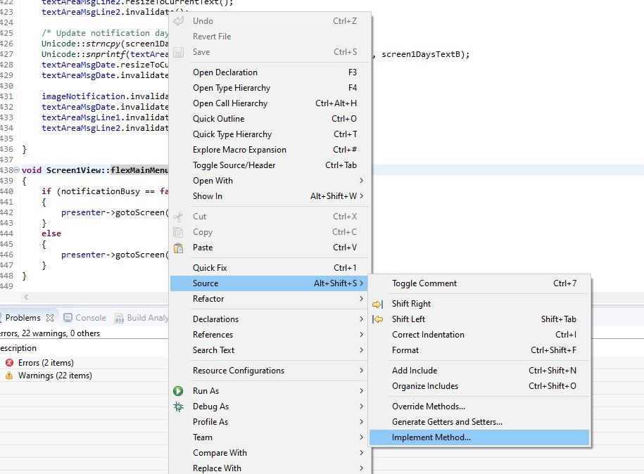

I spent a fair bit of time trying to find where the linker was struggling to consolidate the project links but in the end I found that right clicking on the function declaration caising the problem and using / source / implement method fixed the broken links in the linking process.
I'm not clear why things got snagged in the first place as it had been working for an earier project. Since using implement method the existing "new Virtual functions" and any added since have all behaved and linked without issue.
