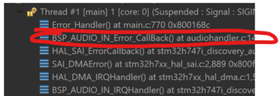

I am trying to fill a buffer from the on-board MEMS microphone using the BSP_AUDIO_IN_RecordPDM() function. However, execution pauses around HAL_SAI_Receive_DMA() and the BSP_AUDIO_IN_IRQHandler() is called. The stack trace is as follows:

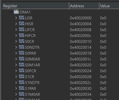

Checking the hdma variable on the debugger, I can see the error code is 1, corresponding (I believe) to a transfer error. I tried looking at the relevant registers with breakpoints, but they were at 0x0 at every point:

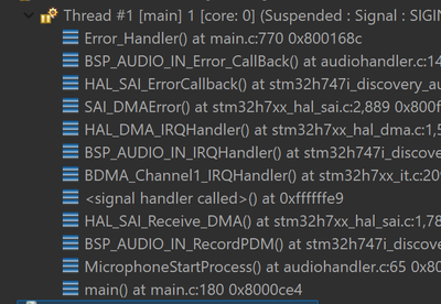

Where exactly is Error_Handler being called and why? Stack trace is there, should be easy to find out.
2025-07-10 8:52 PM
Sorry, I'm not entirely sure I understand. I've only been using the IDE for a few weeks so I may be missing something. Is there something I can print out from inside the Error_Handler to help me debug? The function itself takes in no arguments.
Unless you mean following the stack trace, in which case it looks like the HAL_SAI_Receive_DMA() function is erroring in line 9 in the code below (although it sometimes errors in line 16). After that the stack trace has a "signal handler" at 0xffffffe9 which the IDE is unable to show me, and after that it enters the cascade of interrupt handlers.

This is where Error_Handler gets called according to the stack trace.
2025-07-10 9:11 PM
Not a lot going on there...

So keep going down the chain until you see why it was called.
HAL_SAI_Receive_DMA is in the main thread, before the interrupt happened. Error handler was called within the interrupt.

I know, the issue is that signal handler I am unable to read is that critical spot between HAL_SAI_Receive_DMA() and the interrupt
