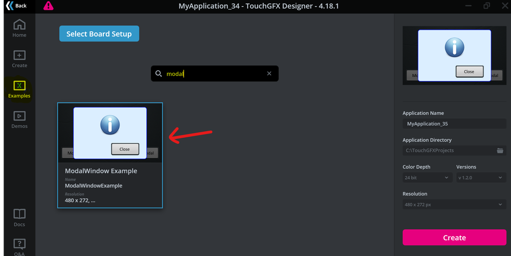

By the way, just remembered, we actually have a example in TouchGFX Designer about popup, it's called "ModalWindow Example".
/Osman
