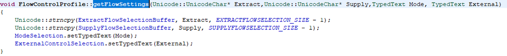

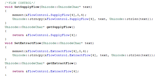

Hi I encountered with a problem. In model.hpp I have struct and how u see in buffer are these symbols '-':
I take this buffer like this:
And when values are updated:
The problem is that its not render correctly. Here needs to be "-- m3/h" but I got this
Where is the problem?

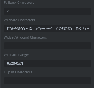

Did you remember to add the - character to the wildcard character list for the typography you need it to appear in? (In the designer: Texts->Typographies->Wildcard Characters)

@Michael K
