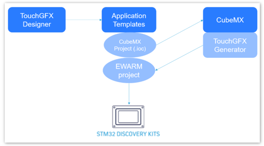

The different flows should be described in the documentation.
CubeMX is an MCU configurator. If you go by the board selector you'll get default IP configurations (But Generator is not connected to the board selector). However, if you now select Parallel RGB from the Generator display interface section you'll inherit the LTDC settings for w/h (480x272 - The default for custom display interface is 32x32.
What we're trying to do is to have APPLICATION TEMPLATES accessible from within the designer that uses the MCU configurator (CUBEMX) + additional code (BSP) to prepare memories and touch controller to run TouchGFX.
The dream is to use CubeMX only in the event that you have a custom board with an MCU you need to configure, or if you have your ST development board that you need to make adjustments to (for prototyping).
/Martin
2020-01-14 6:16 AM
If you use CubeMX to generate a project from scratch then this IS your application template. You're trying to do something for a custom platform. The designer then allows you to select a UI to put on top of that template - EMPTY or one of the examples.
Start from the designer if you want to have everything configured and just want to create a UI for your stm32 development kit. This once started from CubeMX, from scratch as well, but now we packaged it up for you including the .ioc file that works with the new Generator.
I must have done a right terrible job explaining this in the documentation.
We're working, right now, on updating all ATs to be cubemx 5.5'ified - its a work in progress. So far you can use the H7B3-DK and the F746g-disco, 769-disco is on its way and so is the L4R9-disco, etc etc.
/Martin
