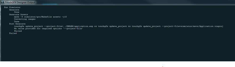

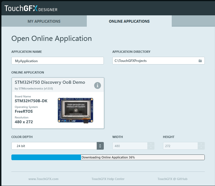

2020-01-12 7:14 PM
Hi @Martin KJELDSEN
I successfully downloaded the STM32 Discovery OoB Demo using touchGFX designer 4.13.0, but it cannot be simulated. Why is this?
