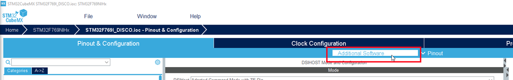

In the "TouchGFX HAL Development" page it says:
"After installing TouchGFX Generator through CubeMX or manually (See "installing TouchGFX"), users can now enable the TouchGFX Generator for almost any MCU in CubeMX. TouchGFX Generator is activated through "Additional Software""
Where is this "Additional Software" option in CubeMX?
Thanks,
Eyal
2020-01-08 2:28 AM
Hi @egoltzman,
The "Additional Software" option is located at the top of CubeMX
Best Regards
Anders
2020-01-08 3:05 AM
Hi Eyal,
That's the most asked question so far, so we'll go ahead and update the live documentation to explicitly mark where "Additional Software" is actually located.
/Martin
