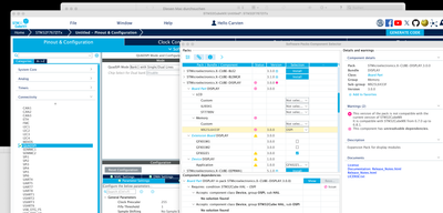

Now I tried with CubeMX to installed the Hello World Example provided.
But now I get the Message that these Packets is not Support with CubeMX 6.11. It should be support by Version 6.7 until 6.8.2.
I tested 6.8.2 and 6.8 but without any changes. It seams like the SPI does not fit together. Always I got no solution found.

i Started from scratch with the MCU only instead of the Nucleo Board.
The Problem is the memory and SPI configuration
How can I fix these?

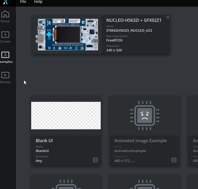

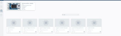

2024-05-17 12:01 PM
Hi Gaetan,
I followed your guidance to use Touchgfx instead and use the starting Point of a existing Example for the LCD Board with STM32U575.
See the image attached. If i go in detail, no example is available. The resolution does not fit and I am not able to choose one to move forward.
Thanks
Carsten
2024-05-21 2:00 AM
Hello @Carsten73 ,
Yes, we don't have examples for 240*320 pixels screen.
You should be able to create a blank UI :
From there you can add elements in Designer.
If you really want to see how examples work, you can just select them without selecting a board but instead selecting the simulator.
